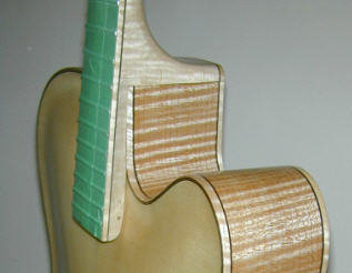

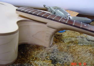

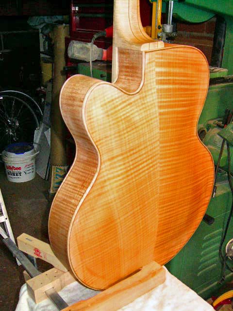

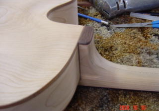

I wanted a 12, made a 6 first & well, the archtop bug got me. The first instrunent I made was an F Mandolin. I figured--- how hard could it be. Around 600 hours later (much of it building jigs) I discovered that since the guitar body was made before the neck. As a result of not looking closely enough at the Benedetto book, I should have had roughly 1 1/8" of body to the cutaway (from the guitar center)at the body/neck joint. ( the neck is roughly 2 1/4" at the 14th fret) I was 1/8" off on the cutaway side. Sooo- I had to modify the neck heel slightly so it would blend with the cutaway. It doesn't look TOO terrible, but the neck extension and fretboard extend out over the cutaway (may not be a totally bad thing) On my next (already have the wood) I'll increase the size of the body mold at that point by 1/4" by gluing a spacer into the neck end of the mold. (My mold is a 2 part mold so I can get things out easily by removing a few screws) Will it work?
Phil

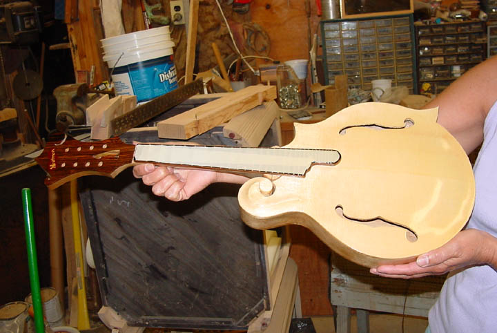

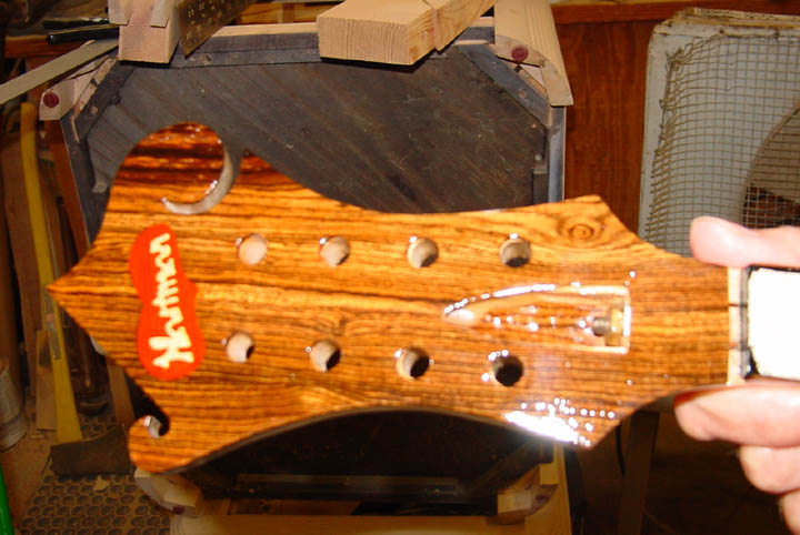

Here is a pic of the mando that got it all started -- BTW- Plays & sounds great
PostPosted: Thu Oct 12, 2006 11:14 am
Joined: Thu Oct 12, 2006 9:54 am
Posts: 17
Well, It's not really finished-- Just some piddly things like finishing the recrown on the last 7 frets, spraying & buffing-- But, since you insist:
and

Forgot-- For those interested:
FS maple back & sides
Alaskan Stika Top
Walnut binding
Maple inlaid peghead
Rosewood accents (not shown) Will post when everything is assembeled
pearl dots (my first)
Rosewood fingerboard & heel cap
phil

Phil, I build most of my Archtops so that my neck extension over hangs the cutaway by just under 1/8” at the 14th fret neck/body joint. Personally I like the look. In your first picture shown has the neck already been glued to the body? From the picture it looks like you still have to remove some of the excess wood from the neck extension. If such is the case you’ll be able to blend it just fine.
Here's a picture of one in progress that illustrates how much mine over hang at the neck/body joint.
Here's a later picture that hopefully shows how the neck extension blends nicely with the body at the neck/body joint.
Anthony Z39002.9823958333

Anthony-- The neck is glued on & I don't yet have a pic of the blending I did. Will post soon

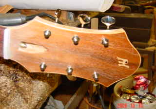

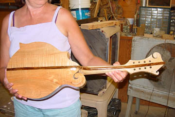

Finally found some pics of the mandolin I thought I'd lost
Please ignore the lousy photography-- The peghead is veneered 1/16" with Wenge-- The stripe down the neck & back is Wenge-- The inlay is Maple into Paduak-- Note, I did not bind this instrument -- Was way too scary at the time-- 'Tis still scary, but I did bind the guitar- somewhat
